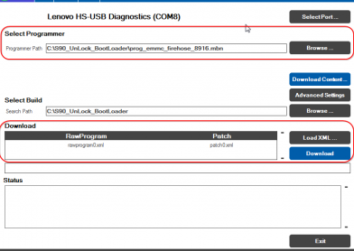

Start DownloadCOM Port number:8Switch To EDLProgram Path:C:\S90_UnLock_BootLoader\prog_emmc_firehose_8916.mbnCOM Port number:11Sahara Connecting ...Sahara Version:2Start Sending ProgrammerSending Programmer FinishedSwitch To FireHoseMax Payload Size to Target:49152 BytesDevice Type:eMMCPlatform:8x26Disable Ack Raw Data Every N PacketsAck Raw Data:FalseSkip Write:FalseAlways Validate:FalseUse Verbose:FalseCOM Port number:11Sending NOPFireHose NOP sent successfullySending ConfigurationDevice Type:eMMCPlatform:8x26Set TxBuffer 0x4000, RxBuffer 0x4000Firehose configure packet sent successfully!Total Bytes To Program 0xE5AA0Download ImagePROGRAM: Partition 0, Sector: 0, Length: 33 Sectors, Sector Size: 512 BytesFile: C:\S90_UnLock_BootLoader\gpt_backup0.binPROGRAM: Written Bytes 0x4200 (64)Program Size: 0.02 MBPROGRAM: Partition 0, Sector: 0, Length: 34 Sectors, Sector Size: 512 BytesFile: C:\S90_UnLock_BootLoader\gpt_main0.binPROGRAM: Written Bytes 0x4400 (64)Program Size: 0.02 MBPROGRAM: Replace the partition sectors number 0x1000 to file size in sector 0x6eaPROGRAM: Partition 0, Sector: 268288, Length: 1770 Sectors, Sector Size: 512 BytesFile: C:\S90_UnLock_BootLoader\emmc_appsboot.mbnPROGRAM: Written Bytes 0xdd400 (64)Program Size: 0.86 MBPROGRAM: Replace the partition sectors number 0x1000 to file size in sector 0x6eaPROGRAM: Partition 0, Sector: 264192, Length: 1770 Sectors, Sector Size: 512 BytesFile: C:\S90_UnLock_BootLoader\emmc_appsboot.mbnPROGRAM: Written Bytes 0xdd400 (64)Program Size: 0.86 MBTotal Size: 1.76 MBTotal Size: 0 SecondsPATCH: Partition 0, Sector: 9, Offset 424 Bytes, Size: 8 Bytes, Value: NUM_DISK_SECTORS-34.PATCH: Partition 0, Sector: 0, Offset 424 Bytes, Size: 8 Bytes, Value: NUM_DISK_SECTORS-34.PATCH: Partition 0, Sector: 1, Offset 48 Bytes, Size: 8 Bytes, Value: NUM_DISK_SECTORS-34.PATCH: Partition 0, Sector: 0, Offset 48 Bytes, Size: 8 Bytes, Value: NUM_DISK_SECTORS-34.PATCH: Partition 0, Sector: 1, Offset 32 Bytes, Size: 8 Bytes, Value: NUM_DISK_SECTORS-1.PATCH: Partition 0, Sector: 0, Offset 24 Bytes, Size: 8 Bytes, Value: NUM_DISK_SECTORS-1.PATCH: Partition 0, Sector: 0, Offset 72 Bytes, Size: 8 Bytes, Value: NUM_DISK_SECTORS-33.PATCH: Partition 0, Sector: 1, Offset 88 Bytes, Size: 4 Bytes, Value: CRC32(2,4096)PATCH: Partition 0, Sector: 0, Offset 88 Bytes, Size: 4 Bytes, Value: CRC32(NUM_DISK_SECTORS-33.,4096)PATCH: Partition 0, Sector: 1, Offset 16 Bytes, Size: 4 Bytes, Value: 0PATCH: Partition 0, Sector: 1, Offset 16 Bytes, Size: 4 Bytes, Value: CRC32(1,92)PATCH: Partition 0, Sector: 0, Offset 16 Bytes, Size: 4 Bytes, Value: 0PATCH: Partition 0, Sector: 0, Offset 16 Bytes, Size: 4 Bytes, Value: CRC32(NUM_DISK_SECTORS-1.,92)Total download file size: 1,76123MBThroughput: 0M/sReset PhoneWaiting for reset done...Finish Download
