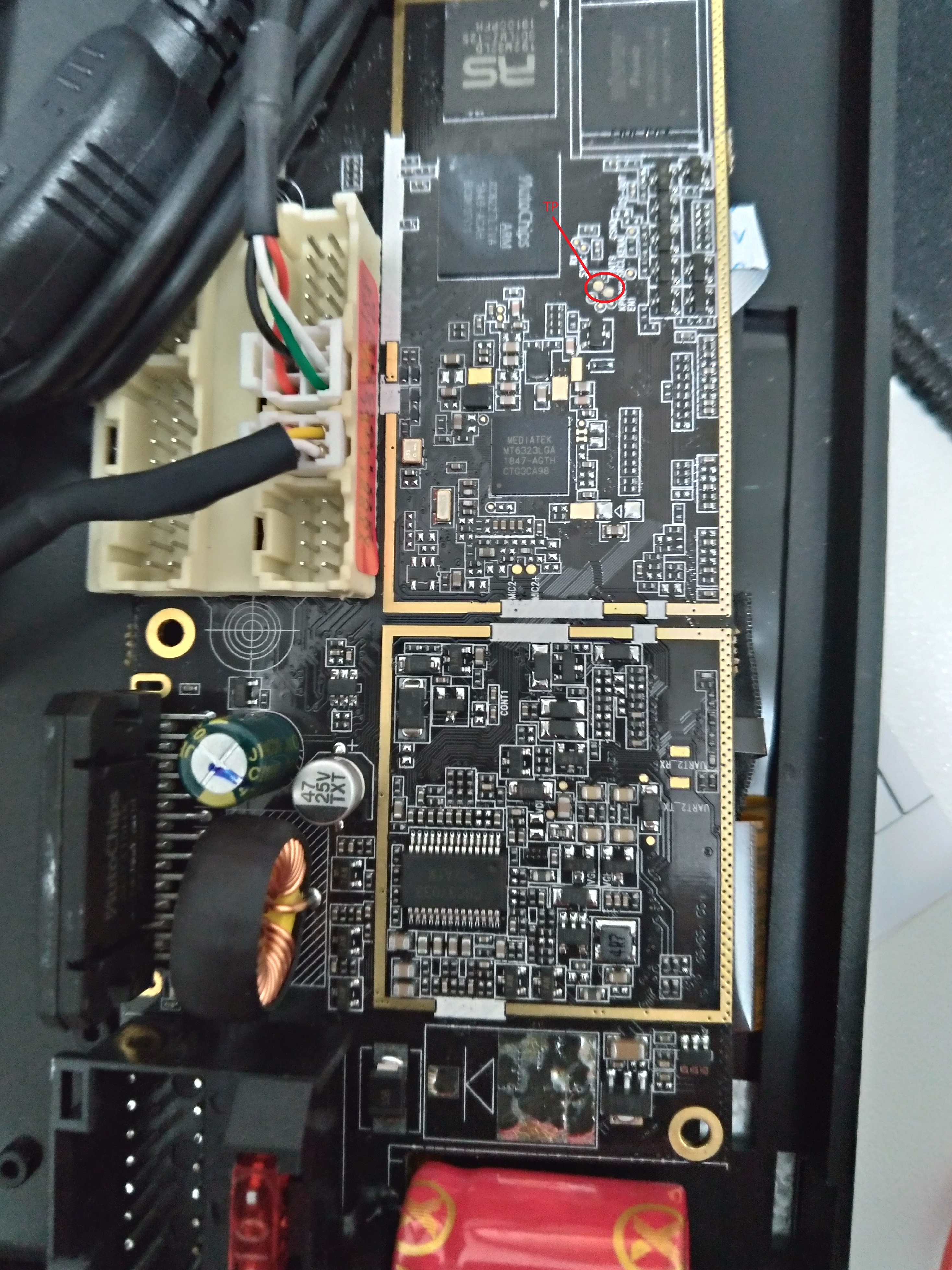

    It has multiples number on main board.
    The numbers that u need are these?
    YT9217 V1.61 16G
    A005-YT9217C004
    20190325
    I can sent you pictures if need.
    The boot erro started after I change startup logo by a jpeg imagem

    Only way for device to be recognized by windows is by TP (test point), but when release TP the windows lost connection and flash tool fail.
    Picture of my main board atthaced.
